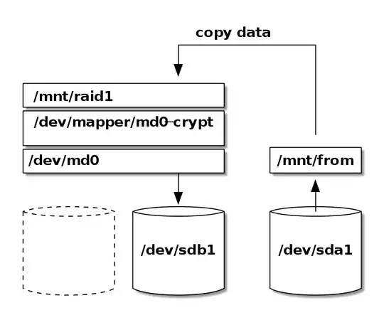

Set up an encrypted NAS on Odroid-C2 or Rasbperry 3 with OpenMediaVault
15 pages step by step manual: http://getreu.net/public/downloads/doc/encrypted-raid1-nas/
