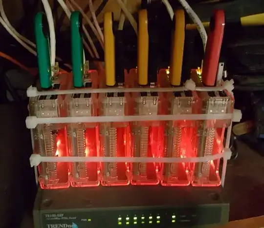

While not doing this with compute modules, I have 6 PI3's running together to test HA setups (database cluster sometimes, load balanced nginx servers other times). It's way cheaper to buy 6 pi's (and the various and sundry parts to get them running) than it is to lease 6 virtual machines or buy even a modest computer capable of hosting 6 VM's simultaneously.
I think it cost me around $350 to fully setup 6 pi's on a dedicated switch. They're all zip tied together, so it's like a little football sized cluster with blinky lights which my wife hates (so I put them in clear cases).
There are reasons to do it, but it isn't powerful, by any means. I actually like the lack of power. If I can achieve an acceptable level of performance on my Pi setup - I know I can make it scream when I put the same config to real hardware.
