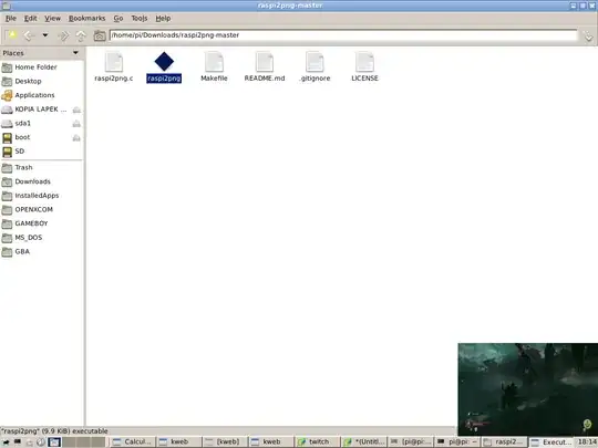

On my 1024x768 setup it looks like this :
"--win \"784 588 1024 748\"
      a   b    c   d
a) how far to the right is the top-left corner of the window (1024-240)
b) how far down is the top-left corner of the window (768-180)
c) where the window should end (width)
d) where the window should end (height)
My window is 20px above the edge of the screen to keep my panel visible.
As a result you get a 240x180 window placed at the bottom right corner right above the panel.
LotF Rpi
EDIT : I used backslashes to use omxplayer in twitch streaming script
livestreamer twitch.tv/$1 $2 --player omxplayer --fifo --player-args "--win \"784 588 1024 748\" {filename}"
They shouldn't be necessary in normal usage.
