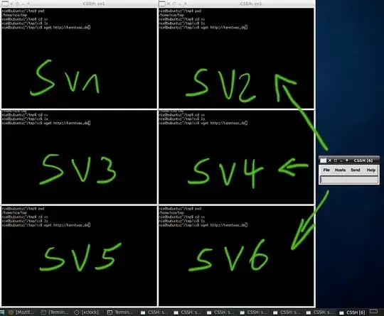

clusterssh allows you to connect via SSH to multiple servers and send the same commands to each one : clusterssh annotated screenshot

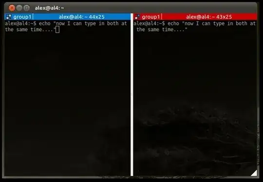

You could also use a terminal emulator that supports groups, such as terminator terminator groups
