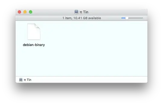

For example, if you tell Netatalk to share the root of the storage by adding:
/               "π Tin"
to the /etc/netatalk/Applevolumes.default file on your pi before the # End of File you will likely see a nearly empty volume = your when you open the π Tin volume from your Mac (aka file share, shared folder):

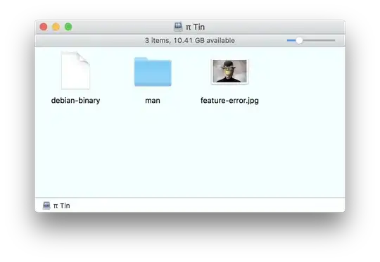

Then for fun, set the "execute" bit off on the /man directory on your pi like this:
sudo chmod o-x /man
That directory or "folder" should have shown under the π Tin volume with a whole bunch of others when you first opened it...but it didn't. Now, after executing the command line above and then opening the π Tin volume, you will magically see the "man" folder show up:
enter image description here (you may have to "disconnect" and "reconnect" from your Mac to see the changes faster)

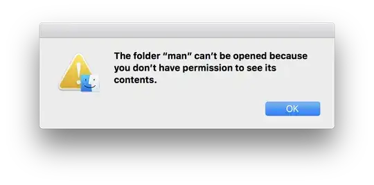

But because you told the pi's file system to not allow "others" to "execute" aka display folder contents listing, you can't open it from your Mac regardless of the "read" setting on the folder.

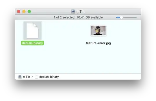

(note, you can add a file to the pi's storage root and it shows up fine so you know it is working... feature-error.jpg for example)
