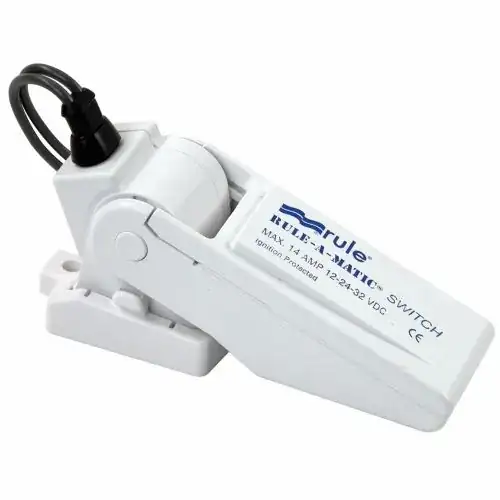

If you have the room I recommend using an off the shelf Bilge Pump Float Sensor that is designed to trigger a bilge pump in a boat. They are often high quality (if it fails, it could sink your boat) and cheap (walmart). They are essentially single pole switches which are closed when the water level is higher than it, and open when the water level is below it. Many of these use magnetic reed switches that never touch the water even when fully submerged. (it's tough)
Pros:
  • cheap
  • reliable
  • simple to interface
Cons:
  • Size (maybe)
  • Has to touch the water

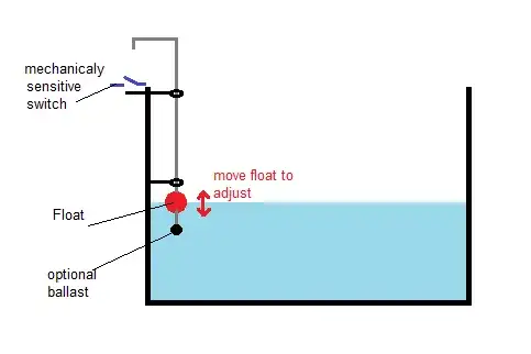

What about something like this?
This is simplified drawing to show you idea.

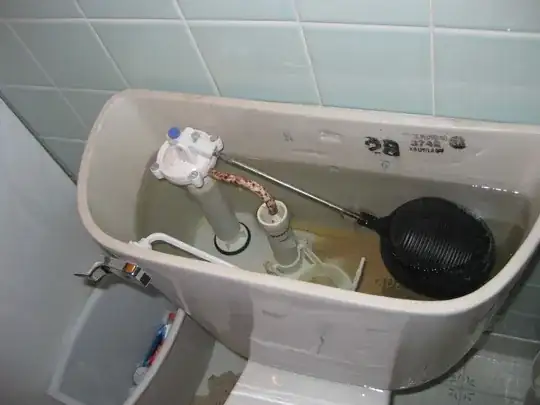

Maybe you should build something like toilet reservoir valve:
(image source: link)
If you need digital signal (when specyfic level is reached) - you can use simple switch. If you need analog value - use potentiometer.
