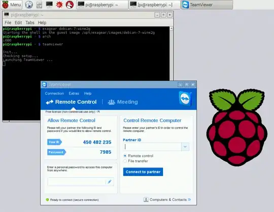

You can run x86 version of Teamviewer using ExaGear Desktop emulator
  1. Install ExaGear Desktop (note that ExaGear isn't free and you have to obtain the license)
    tar -xvzpf exagear-desktop-rpi2.tar.gz
    sudo ./install-exagear.sh
  2. Run ExaGear Desktop
    exagear
  3. Download TeamViewer
    sudo apt-get install wget
    wget http://download.teamviewer.com/download/teamviewer_i386.deb
  4. Install TeamViewer
    sudo dpkg -i teamviewer_i386.deb
    sudo apt-get install -f
  5. Teamviewer port for Linux is based on Wine. Raspbian use a bit different virtual memory configuration than Wine expects, so you have to patch wine
    wget http://s3.amazonaws.com/wine1.6-2g-2g/wine1.6-2g-2g.tar.gz
    tar -xzvf wine1.6-2g-2g.tar.gz
    sudo ./teamviewer-fix-2g.sh
  6. Now you can run teamviewer
    teamviewer
    Run Teamviewer on Raspberry Pi
Based on this post.
