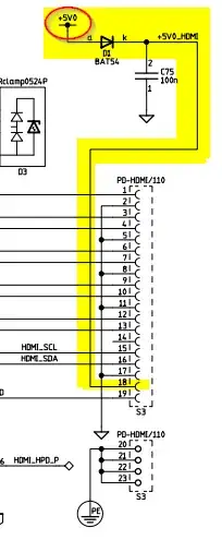

Unfortunately not, 5v is connected directly to the HDMI port and there is no way to toggle that power supply.
If you were desperate to this you could cut the 5V PCB trace and make your own switch, using a transistor and GPIO pin. But that will void any warranties.
