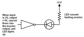

Your solution is simple, use an inverter, and a start up script. When The script runs, have an IO pin go high, which will force the LED off. When the OS is off, and the script driving the IO pin is off, the LED will illuminate.

Here is a picture of the schematic.
Invert output
Now, if you wanted to get a little extra fancy, you could have a green and red LED, one on either side of the inverter. When the OS is on, one led would be driving high the green LED, and low on the RED LED low. then when the OS were off, the green led would be off, and the red led, on. (I think that would be neat.) or not. do whatever you like.
