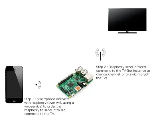

I would like to control my TV using a Raspberry Pi. I would like my Raspberry Pi to act like a TV remote controller.
What kind of hardware do I need to make it? Do I need something like IR emitter, and if so, where to buy such hardware? …or does the Raspberry Pi already have an IR transmitter and I didn't know?
I have already Google'd my question but the topics I found speak about how to control the Raspberry Pi with Infrared which it's not what I want. I want the opposite: I want my Raspberry Pi to control my TV using IR. I also found we can control the TV thanks to HDMI cable (if TV is compatible) but this unfortunately not convenient to me.
Here is a schema that explain how see the thing. My question is about step 2:
Schema
