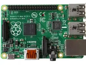

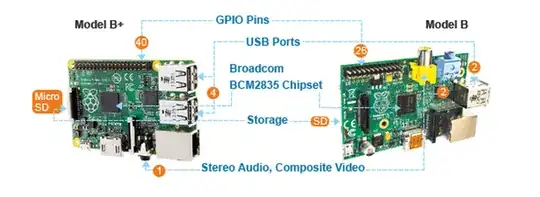

Here's a list of the key differences (taken from my own blog at http://www.recantha.co.uk/blog/?p=10323)
  • 4 USB ports – for the first time, you’ll be able to have a keyboard, mouse and wifi dongle plugged in without needing a powered hub. Bear in mind, you will probably need a more powerful power supply for the B+ if you want to use all 4 ports. They’re recommending a 2A supply. Of course, if you’re just using a mouse and a keyboard then a 1A supply will probably be absolutely fine.
  • Better USB hot plug capability – you should be able to plug in your wifi dongles in without reboots!
  • A new Ethernet port with activity lights.
  • The USB and Ethernet ports are now all in a straight line, rather than in the B’s staggered arrangement.
  • The yellow composite video port has gone and there is now a combined 3.5mm jack that provides audio and the analogue video signal.
  • The HDMI port, the CSI (camera) and DSI (display) ports have all moved slightly.
  • The micro USB power socket has changed sides. This means that all the ports are on the same side of the Pi – so cable management is much better with the B+.
  • The B+ sports a 40-pin GPIO header (compared to the B’s 26) and no longer has a P5 and P3 header. All the GPIO is on that one header now. The 26 pins to the left (nearest the corner) are backwards compatible so all your add-on boards will work (with the exception of any audio boards like the Wolfson which requires the P5 header which is, of course, not on the B+).
  • 4 mounting holes, conveniently located on the corners of the board rather than the 2 oddly-placed holes on the B.
  • On the back, the B+ uses a micro SD card (as opposed to the B’s full size SD card) with a push-push action (i.e. you push it in and it locks in place, you push it again and it clicks out). The card still protrudes slightly (presumably to make it easy to remove) but the (metal) slot is a vast improvement on the flimsy plastic of the B.
  • Much clearer silk screen labelling in general.
  • Lower power requirements – it will use between 0.5 watts and 1 watt less than the model B.
  • Much better audio output thanks to a dedicated power supply.
  • Rounded corners! (Still doesn’t fit in an Altoids tin but who cares! The aesthetic change is welcome)

You cannot do anything more, or special with the B+ other than connect a few more GPIO. Software is all the same across A,B and B+. B and B+ already have maximum RAM of 512MB SDRAM.
The main differences are:
  • More PINS in row! (Original 26 + New 14) new ones with a total of 40 but 2 headers less
    • As pointed out by @joan total GPIO's (General Input Output)
    • B = 17 increased to B+ = 26
  • 2 more USB ports thanks to the new LAN chip. Still 100mb LAN
  • Micro SD instead of bulky SD
  • Better power! This is great for WiFi and generally is more efficient!
  • Better audio thank to better power circuits!
  • Different form factor with 4 square mounting holes and the USB connectors are flush with the edge.
