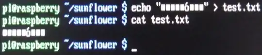

I'm trying to configure my Raspbian to support console output in my native language (Polish). After updating my locale preferences (I chose pl_PL.UTF-8 as my default locale), I ran a test - I typed some non-ASCII characters needed to represent strings in Polish, and saved them into a file:
It seems the default font doesn't support UTF-8, I guess... I downloaded the file and viewed it in a text editor on my Windows machine:

How do I set a UTF-8-compatible font in the "physical" Raspbian console and how do I set up the SSH connection to display the characters properly?
