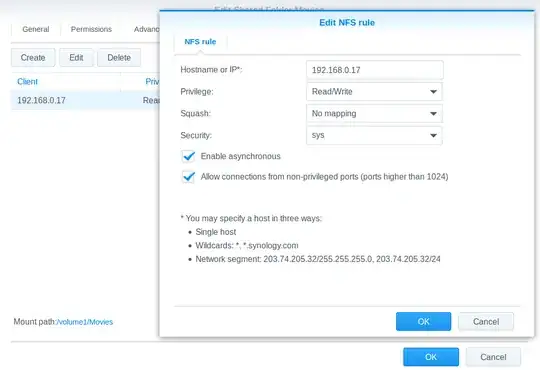

I would like to mount a NFS folder share from my Synology NAS on my RPi. So far, all my efforts have been unsucessful.
I get stuck on :
pi@raspberrypi ~ $ sudo mount -t nfs 192.168.0.100:/volumes1/Movies /mnt/Movies
mount.nfs: access denied by server while mounting 192.168.0.100:/volumes1/Movies
Guides followed :
https://www.synology.com/en-us/support/tutorials/566
http://wiki.xbmc.org/index.php?title=NFS#Synology
http://www.robvanhamersveld.nl/2012/12/14/share-media-from-synology-to-xbmc-with-nfs/
Topology :
Devices :
RPi - NFS Client OS: Raspbian Synology NAS - NFS Server OS:DSM5.0
IP :
RPi - 192.168.0.17
Synology NAS - 192.168.0.100
Actual state and configuration :
Synology Configuration
Export file
DS> cat /etc/exports
/volume1/Movies 192.168.0.17(rw,async,no_wdelay,insecure,no_root_squash,anonuid=1000,anongid=100)
Folder permission to share
DS> ls -ls /volume1/ | grep Movies
   4 drwxrwxrwx    2 root     root          4096 Jul 23 07:14 Movies
uid and gud on raspberry
pi@raspberrypi ~ $ id
uid=1000(pi) gid=1000(pi) groups=1000(pi),4(adm),20(dialout),24(cdrom),27(sudo),29(audio),44(video),46(plugdev),60(games),100(users),105(netdev),999(input),1001(indiecity),1002(spi),1003(gpio)
I think the issue is related with uid and gud but I don't know how to match it on client.
Thanks for all advices and possibles solutions.

The error might mean you can't mount it locally, even though it says server. Everything looks to be set up fine on the Synology.
You might just want to allow everybody on your LAN to access that share for now. In IP add this. Just to make sure restart it after changing settings on NFS.
192.168.0.0/24
I am not sure what the security tab does in synology but if you can view /etc/exports on the synology there should be an entry similar to this.
/volumes1/Movies 192.168.0.0/24(rw,sync,no_subtree_check)
Make sure your mount directories are created properly on the Pi
sudo mkdir -p /mnt/movies
sudo chmod 777 /mnt/movies
You should be able to mount it easily just like this on the Pi
sudo mount 192.168.0.100:/volumes1/Movies /mnt/movies
This really shouldn't be that complicated, you might just be looking at the wrong place. I hope this solves your issue.

For Synology DSM 5.1, Set Privilege to "Read only" (unless you want your pi to write files) and Squash to "Map all users to admin"

The actual error may be that you are trying to mount /volumes1/Movies which is a typo error to ls -ls /volume1/ | grep Movies
Andreas B
I used cifs connections before and did not see /volume1 was missing. The following examples are working in my configuration similar to the ones above:
sudo mount -t nfs 192.168.178.62:/volume1/pi/client0 /mnt
sudo mount -t nfs DiskStation.local:/volume1/pi/client0 /mnt
sudo mount -t cifs -o username=admin //DiskStation.local/pi/client0 /mnt
