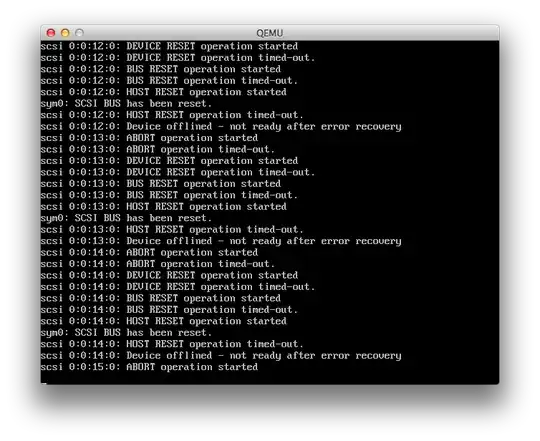

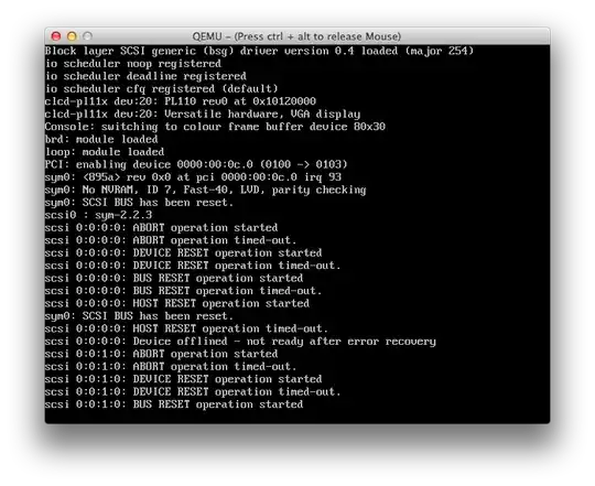

This resulted in a cycle of SCSI errors,
ABORT, DEVICE RESET, BUS RESET, HOST RESET, sym0: SCSI BUS has been reset, HOST RESET, Device offlined
and so on, cycling through ever increasing SCSI device IDs, n, (scsi 0:0:*n*:0). n = {0, 1, 2... 6, 8, 9... 15} 7 was skipped as it is presumably the host controller.
Screenshot of QEMU window first run #1
It would cycle up to SCSI ID=14,
Screenshot of QEMU window first run #2
with the console in the QEMU window eventually crashing, at SCSI ID=15,
Screenshot of QEMU window first run #3
leaving the following error in the terminal from which it was run.

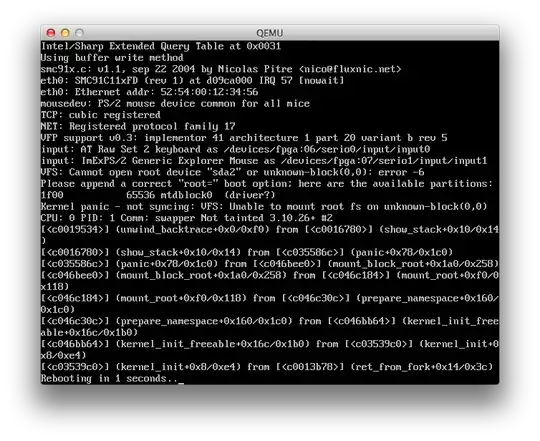

I thought that the issue was the root=/dev/sda2. Copying the Raspbian image locally didn't help (it had been on a separate partition). Looking at the comments on the web page, a number of people were getting the same SCSI errors.
It appeared to be an issue with the version of QEMU. I was using 1.1.50

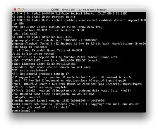

And running the first boot command
qemu-system-arm -kernel kernel-qemu -cpu arm1176 -m 256 -M versatilepb -no-reboot -serial stdio -append "root=/dev/sda2 panic=1 rootfstype=ext4 rw init=/bin/bash" -hda 2013-09-25-wheezy-raspbian.img
this time resulted in the expected command prompt.
I ran through the suggested edits of /etc/ld.so.preload and /etc/udev/rules.d/90-qemu.rules, without any issues arising.

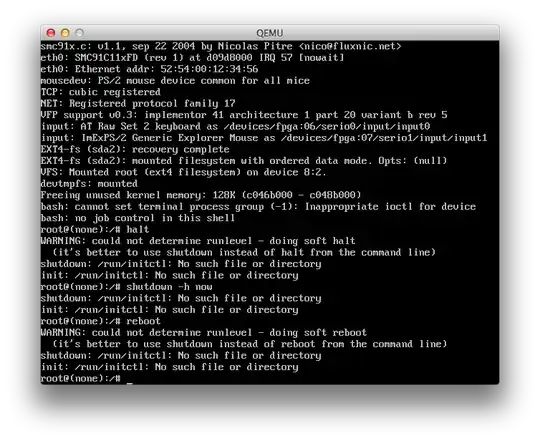

Screenshot of halt errors
There was a "better" way of shutting down though, as I was given the tip (see below) that
reboot -f
worked.
In an attempt to lose the init errors, after some more googling3, I ran the following commands:
mkfifo /dev/initctl
but, predictably, it was not persistent, and didn't fix shutdown.
mkfifo /run/initctl
which was persistent, but didn't fix the shutdown.
I encountered henje on Super User having the same issue. From shutdown: /run/initctl: No such file or directory
Thx for the reboot -f. Good tip. After further googling, a hard reboot is supposed to fix the issue, but it hasn't. I have also run mkfifo /run/initctl which stops the No such file or directory error, but still doesn't shut the system down. I now get init: timeout opening/writing control channel /run/initctl. I have compared the /run/initctl just created, with the one on my working RPi, and they look identical: prw------- 1 root root 0 Jan 1 1970 /run/initctl.

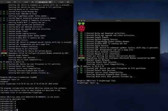

This works for me on MacOS Mojave,
Create a file called qemu_script.sh and copy-paste the code below
nano qemu_script.sh
give execution perms and execute,
$ chmod +x qemu_script.sh
$ ./qemu_script.sh
Code:
#!/bin/sh
brew install qemu
export QEMU=$(which qemu-system-arm)
export TMP_DIR=~/tmp/qemu-rpi
export RPI_KERNEL=${TMP_DIR}/kernel-qemu-4.14.79-stretch
export RPI_FS=${TMP_DIR}/2018-11-13-raspbian-stretch-lite.img
export PTB_FILE=${TMP_DIR}/versatile-pb.dtb
export IMAGE_FILE=2018-11-13-raspbian-stretch-lite.zip
export IMAGE=http://downloads.raspberrypi.org/raspbian_lite/images/raspbian_lite-2018-11-15/${IMAGE_FILE}
mkdir -p $TMP_DIR; cd $TMP_DIR
wget https://github.com/dhruvvyas90/qemu-rpi-kernel/blob/master/kernel-qemu-4.14.79-stretch?raw=true \
        -O ${RPI_KERNEL}
wget https://github.com/dhruvvyas90/qemu-rpi-kernel/raw/master/versatile-pb.dtb \
        -O ${PTB_FILE}
wget $IMAGE
unzip $IMAGE_FILE
$QEMU -kernel ${RPI_KERNEL} \
    -cpu arm1176 -m 256 -M versatilepb \
    -dtb ${PTB_FILE} -no-reboot \
    -serial stdio -append "root=/dev/sda2 panic=1 rootfstype=ext4 rw" \
    -drive "file=${RPI_FS},index=0,media=disk,format=raw" \
    -net user,hostfwd=tcp::5022-:22 -net nic \
You should get: enter image description here
HTH someone
