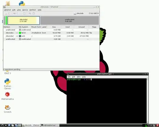

I tried this but it didn't work.enter image description here

The problem most probably exists because you are trying to resize the OS volume and it is locked.
If you have access to an Ubuntu or other Linux desktop I would suggest using gparted on another system.
You can also download a gparted live disk - Burn it and boot from it.
  1. If you have a swap partition on the USB then the FIRST STEP is to move it to the end of the drive
    1. Select the SWAP and click resize/move.
    2. You should be able to visually drag the partition to the far left.(make sure NOT to resize it by any mistake)
    3. Accept
  2. Click on the system partition and then again do a resize/move option.
    1. This time you will drag the right edge of the partition, to resize it, all the way to the far right side.
    2. Accept
  3. Click apply
    1. Let it do its magic ...
So once that is done put the USB Stick card in the Pi and boot it up!
