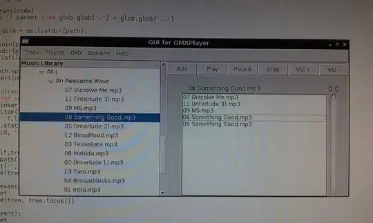

tboplayer seems like what you looking for.
omxplayer itself is just the engine to read and display video. tboplayer is an interface someone built. It starts omxplayer in the console (hidden, you cant see it) and then just relays all the commands to omxplayer via this nice python GUI. It plays audio too :)
Then just create a short cut to the python script, on the LXDE desktop and he can start it when ever he needs too.

Along with tboplayer, I also found omxplayerGUI which is built using Python ans TKinter.
thread on raspberry pi forums link and user manual link
