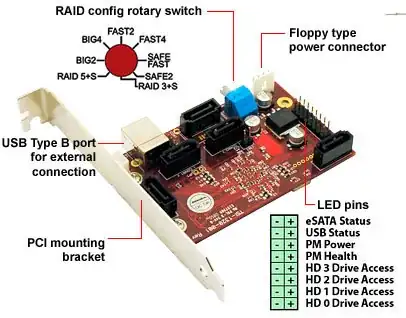

You could offload the Software raid onto a nice USD Raid controller. I am not sure exact models of your external drives but if they have eSATA you can use a cheap converter cable to connect them to this. This will give you maximum Hardware RAID performance, offload the CPU and only USB bandwidth for data and LAN, maximising read speed.

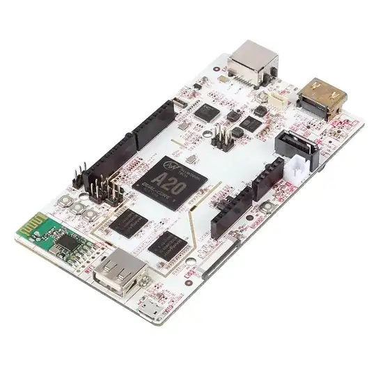

The PcDuino3 A20 is a great alternative to the Pi.
Its got 1GB RAM, Gifagit LAN, Wireless and a SATA Port, where you can attach a port multiplier to connect a whole bunch of Hard drives in RAID. Its great because you can install the full Ubuntu onto it or Android 4.2 possibly even something like RouterOSEverything but ARM? or pfSenseDoes not support ARM :( but FreeBSD is kind of supported which can do all that.
