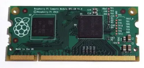

I want to create a massive electrical switchboard PCB (24x 230V relays) with individual current and voltage monitoring using a RPi Compute Module as controller and the GPIO banks for controlling.
The compute module
Do any EAGLE (or other layouting program) example board schematics exist which I can use to create such a board? I'm fine with any OSS license.
