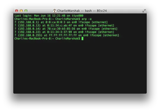

  1. ATTEMPT 2 - I tried plugging in my Raspberry Pi to a router, but did not find its IP address. On the terminal, I used:
    arp -a
I got a list of IP addresses as shown in the picture of my terminal.
My Terminal
I then tried to SSH into the Pi using the command:
ssh pi@IPADDRESS
and each time got connection refused. Then I accessed my router by navigating to http://192.168.0.1/. However, still no new IP addresses was listed there. I then tried downloading the application "Pi Finder". But again, no luck. I then thought maybe the Wi-Fi USB accessory included in the kit might improve my chances. But it did not.
Question for Attempt 2: Where is the IP Address for my Pi? Again, am I experiencing difficulties since I haven't configured my Pi yet? Why is the IP address not showing up?

I just wrote a blog post on how I managed to do it: Install Raspberry Pi headless on OS X. But your problem sounds to me like the system hasn't installed and or booted up correctly. For copying Raspbian on the SD card I used Pi Filler that formatted the card and copied the Raspbian img file onto the card.
I also had problems getting the right IP address as my DHCP was being contrary but Pi Finder did a good job of finding it.
Reto
I've used an Ethernet cable connected directly to my PC. Just follow these steps:
  1. Burn/copy your std RPi img to SD card
  2. Connect your RPi to your PC using a ethernet cable.
  3. Start your RPi.
  4. When started, open a Terminal in your PC and issue: $ ssh pi@raspberrypi.local (password: raspberry). If raspberrypi.local doesn't work, try raspberrypi.
  5. Done.
