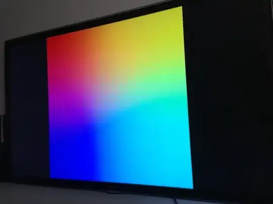

How can I fix a Raspberry Pi with rainbow screen on boot up? I have good voltage coming in and I believe I've formatted and setup the SD card properly. I have two of these boards that do the same thing; I bought them months ago but I am only getting to them now. I bought them off of Amazon and it's way to late to return or exchange them I've been told.
NOTE: I'm using HDMI port, I've tried two SD cards on two different Pis

Do you mean a screen like this?:
debug screen from elinux pic
If you using a RPi 3 B+, it may just be out of date firmware (see here) - you need to use newer image with the right firmware such as the offical Raspbian image - older and derivative images may still need to be updated for now (e.g. OctoPrint [1] [2] [3] )

With current firmware, a coloured splash screen (actually its just four pixels "blown up" by the GPU to full screen) is displayed after GPU firmware (start.elf) is loaded. This should be replaced by linux console a second later. However if the coloured screen remains, it suggests the kernel.img file is failing to boot. Try replacing it with a known good one.
Immediately after displaying the splash screen, the PI starts consuming a little more current. If the PI resets at that moment, it is an indication that the power supply isn't able to deliver the full current your PI requires, but dips its output voltage below a minimum when loaded with the full current the PI needs.
In some cases (Stuck on the Rainbow Screen), freezing at this point has been fixed by adding boot_delay=1 to the config.txt file. This can be done from a Windows PC, which should show several files in the FAT partition on your SD card including bootcode.bin, kernel.img, and config.txt. You can open config.txt in wordpad or any text editor. Add boot_delay=1 and save the file. Don't forget to 'eject' the card before removing it from the card reader. If you are reading the SD card from a working Pi, you can edit the file with sudo nano /boot/config.txt
