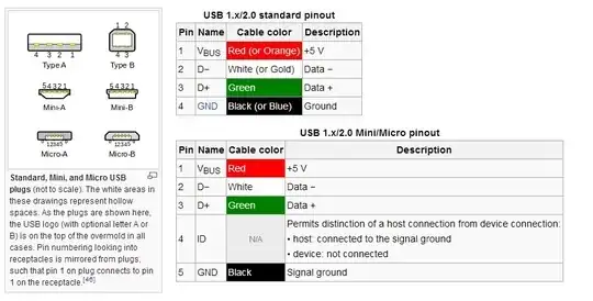

First it is essential to understand what a a USB cable is made up of. Thanks to Wikipedia for the image, please consider donating to them.
What you are interested in is the +5V and GND lines in the USB cables. You can get a seperate (best use a regulated 5A/10A/15A power supply)

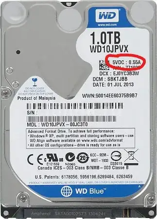

Using trial and error method, I've found you may more or less safely attach 1 (one) low-consumption HDD to one Pi, provided you have an adequate power supply (5V 2A+).
Western Digital WD Blue series HDD has two reasonable priced models: WD10JPVX and WD10JPVT (older one), that have 0.55A current specification and could be easily accomodated with 2 USB slots on RPi.
