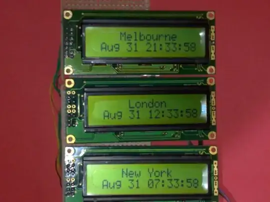

Expanding on this question. I am looking at a few different ways to hook up a HD44780 to the GPIO pins and the various tradeoffs.
Here's my "world clock" running off a RPi using I²C RPi running 3 HD44780 displays via I²C
So far I've just got one working using 6 GPIO pins similar to the tutorial at Adafruit and an I²C version using a MCP23017

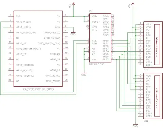

I²C
Hooking it up is fairly straightforward. The contrast pin(VO) of the particular displays I am using needs to be connected to ground. Usually you would connect it to a potentiometer to set the voltage between VSS and VCC
My displays don't have a backlight, so I haven't connected those to reduce clutter on the schematic. If yours has a backlight you should of course connect it in the usual way
You can connect up to 3 displays in parallel to each port of the MCP23017. The only difference is the enable pin from each display needs to connect to a separate pin (GPB1-GPB3)
Raspberry Pi driving HD44780 via MCP23017

def test_i2c(): from datetime import datetime import pytz import smbus
## For Rev1.0 Raspberry Pi
driver1 = LCD_23017(bus=smbus.SMBus(0), addr=0x27, port='B', rs=0, en=1)
driver2 = LCD_23017(bus=smbus.SMBus(0), addr=0x27, port='B', rs=0, en=2)
driver3 = LCD_23017(bus=smbus.SMBus(0), addr=0x27, port='B', rs=0, en=3)
## For Rev2.0 Raspberry Pi
#driver1 = LCD_23017(bus=smbus.SMBus(1), addr=0x27, port='B', rs=0, en=1)
#driver2 = LCD_23017(bus=smbus.SMBus(1), addr=0x27, port='B', rs=0, en=2)
#driver3 = LCD_23017(bus=smbus.SMBus(1), addr=0x27, port='B', rs=0, en=3)
lcd1 = HD47780(driver=driver1, rows=2, width=16)
lcd2 = HD47780(driver=driver2, rows=2, width=16)
lcd3 = HD47780(driver=driver3, rows=2, width=16)
lcd1.lcd_string("    New York")
lcd2.lcd_string("     London")
lcd3.lcd_string("    Melbourne")
new_york_tz = pytz.timezone("America/New_York")
london_tz = pytz.timezone("Europe/London")
melbourne_tz = pytz.timezone("Australia/Melbourne")
while True:
    time.sleep(1-time.time()%1)  # Wait until the next second
    lcd1.lcd_string(datetime.now(new_york_tz).ctime()[3:], line=1)
    lcd2.lcd_string(datetime.now(london_tz).ctime()[3:], line=1)
    lcd3.lcd_string(datetime.now(melbourne_tz).ctime()[3:], line=1)
