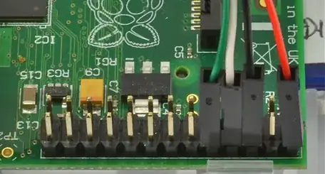

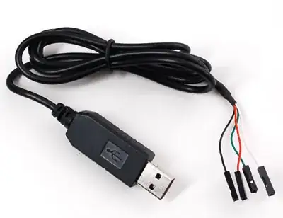

Having hours of problem and doubts, I found out that my adafruit cable had mixed wire connections. Uhm.
In theory, the cable should be as in A, but turns out to be like B:
              A     APurpose  |     B  BPurpose
Wire color   red      5v      |        5v
             black   GND      |        GND
             white   TXD      |        RXD
             green   RXD      |        TXD

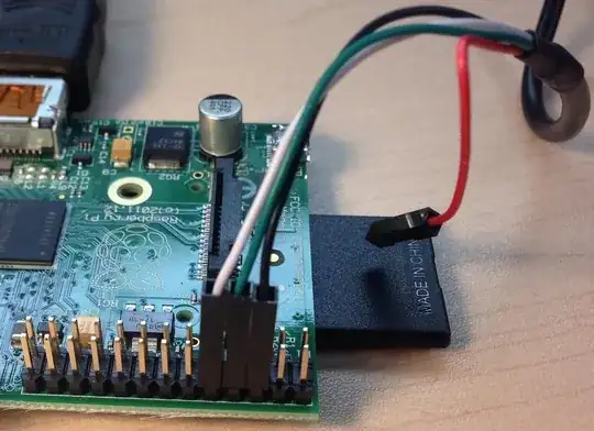

In fact, the only working setup looked like this: Setup of working console cable
When it is specified (here) to connect the white and the green wires like this: enter image description here
I wish to avoid using bad cables on my hardware (raspberryPi, Laptop) and burn my equipment.

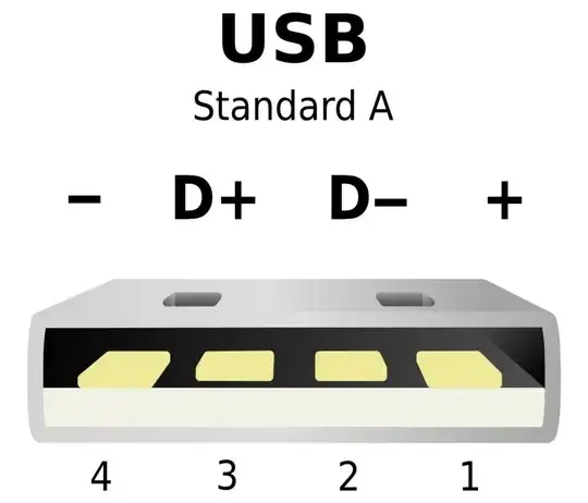

So, based on the following usb pin layout: USB internal pin out
How should I validate each wire's purpose ?
With an independent tester (ohmmeter, voltmeter, ...):
  1. How can I validate each wire and
  2. What should be the correspondence between the colored cable and their usb pinout ?
For example what this correspondence table of the usb console cable should look like:
Usb console cable
   Red wire (5v):     Usb pin#1 ?
   Black wire (gnd):  Usb pin#4 ?
   White wire (txd):  pin#?
   Green wire (rxd):  pin#?

If we accept the Adafruit technical specs, and you bought the dongle from Adafruit.
  1. Leave the red (5V) lead unconnected.
  2. Connect the black (ground) lead to P1-6 (Pi ground).
  3. Connect the green (TX) lead to P1-10 (Pi RXD)
  4. Connect the white (RX) lead to P1-8 (Pi TXD)
http://elinux.org/RPi_Low-level_peripherals for Pi pin numbering.
Even if TX/RX are mislabelled you won't harm the Pi. I've often connected them the wrong way around. It just doesn't work.
Don't try to power the Pi with the dongle. It won't be reliable even if it works at all.

The Adafruit "Technical Details" are quite clear. There are four wires: red power, black ground, white RX into USB port, and green TX out of the USB port.
This is a confusing situation, as you have shown by including the USB pinout in your question.
Compounding the confusion is the use of the same colours that USB uses, but for completely different functions.
There is a chip buried inside the USB plug that is doing the USB-UART conversion.
There is no standard for what white/green means in this situation. There is also no standard that they even use white/green.
You may improve your situation by making sure you buy the same part number from the same manufacturer every time.
If you need to find out which is which, you can try connecting each wire to an LED first. Transmitting at 9600 baud will cause the LED on the TXD line to flash.
