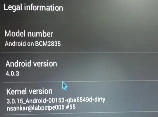

Soon there will be a completely new alternative, Razdroid. It is Android 4 and already has a proven track record for embedded devices (Smartphones/ Google TV/ and posh toasters). A developer (Naren) from Braodcom is the main project contributor and in the final stages of porting Android 4 to the Raspberry Pi.
{Community Mod- It would be great to embed a video right here} Link to video on Youtube
It supports H264 videos nativley and the GUI is slick because it uses OpenGL:ES directly. The only thing left to do is port the sound system. This is potentially the OS for the Raspberry Pi as it is already has tons of application for media centre use and games.
The plan is to merge Razdroid port into the Debian Kernel already available.
You can download beta versions here.
Android 4 reference 1, reference 2

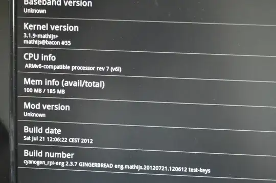

Android 2.1 as mentioned in comments
