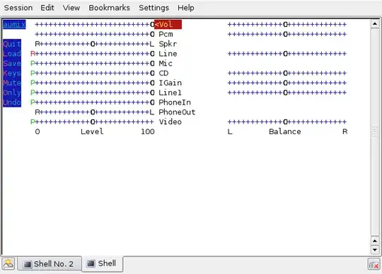

According to this page there is a "sound mixer application in your applications menu", though I haven't found too many references to this, so I think what I'm about to say will be as good an alternative.
There is a very useful aumix tool which provides a visual terminal view (see image), though it won't be what kids are used with standard PCs!
There's some info on it here, here is the author's site, and there is always about.com
Most important options:
  • -v - main volume
  • -b - bass
  • -c - CD
  • -m - microphone
  • -t - treble
  • -q - print all levels
You can set them to a number (eg. -v 88) increment/decrement (eg. -b +10), or use R/P for Record/Play on the mic/CD (eg -c P).

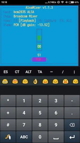

alsamixer comes out-of-the-box and has a text-mode "GUI" which works over ssh.
You can use up/down arrows to control volume, as well as numbers from 0 to 10, which means you can turn your mobile into a fancy "remote volume control", where tapping 1 would be the lowest volume, and 9 the highest.
control raspberrypi volume from mobile phone
Number keypad mode is available (on android) in gboard, swype, swiftkey, etc. Also many keyboards/roms have the option to show arrow keys.
Use any ssh client of your choice, eg, termux, juicessh (android), or termius (ios/android).
Moreover, if you use termux with the termux-widget (€2.09 on google play, or free if you install via f-droid, since the app is open-source), then you can launch alsamixer by tapping in the desktop widget.
