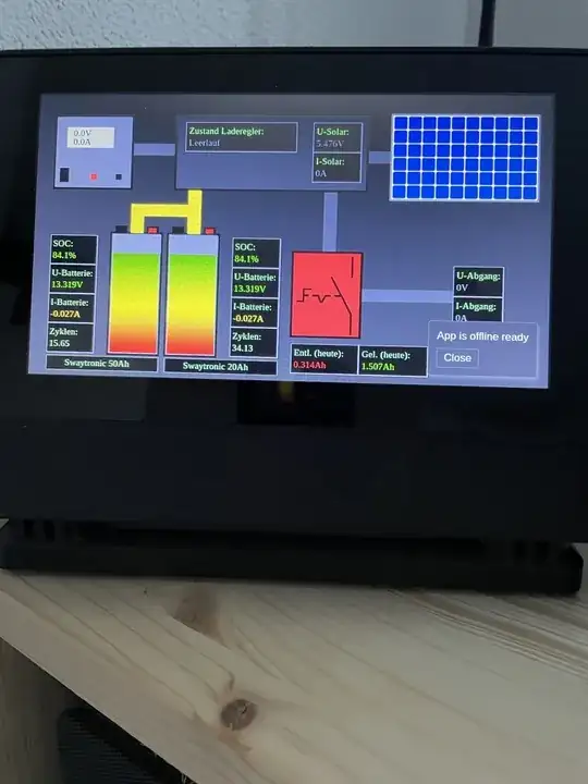

When I start up the RasPi 4, Chromium automatically opens in kiosk mode and loads the nodered dashboard 2.0 of my solar system. However, after about 20 seconds, a message "App is ready offline" appears, which can only be closed manually.
I've already tried using --disable-background-networking (according to ChatGPT), but the message still appears. I'd like to block it somehow or simply close it automatically.
Because I'd like to turn off the Pi completely when it's not in use (overnight, etc.).

@chromium-browser --kiosk  https://hmi:Solar-2023@192.168.1.100:1880/dashboard/pv --disable-background-networking --start-fullscreen --noerrdialogs --no-first-run --hide-scrollbars --ignore-certificate-errors --user-data-dir=/tmp --disk-cache-dir=/dev/null

I know this was a while ago but it's part of the PWA feature in flowfuse dashboard. Add a ui-template node configured to CSS(entire site) and do:
.pwa-toast {
  display: none !important;
This will prevent the popup from showing.
