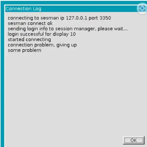

I configured xrdp on ubuntu 22.04 and tried to connect from another windows10 using remote desktop. However, the blue screen will appear after a period of time:
After that, I checked /var/log/xrdp.log with the following error log:

[20250329-13:12:21] [INFO ] connecting to sesman ip 127.0.0.1 port 3350
[20250329-13:12:21] [INFO ] xrdp_wm_log_msg: sesman connect ok
[20250329-13:12:21] [INFO ] sesman connect ok
[20250329-13:12:21] [INFO ] sending login info to session manager, please wait...
[20250329-13:12:21] [INFO ] xrdp_wm_log_msg: login successful for display 10
[20250329-13:12:21] [INFO ] login successful for display 10
[20250329-13:12:21] [INFO ] loaded module 'libxup.so' ok, interface size 10296, version 4
[20250329-13:12:21] [INFO ] started connecting
[20250329-13:12:21] [INFO ] lib_mod_connect: connecting via UNIX socket
[20250329-13:15:51] [INFO ] connection problem, giving up
[20250329-13:15:51] [INFO ] some problem

Does anyone know what's the solvement? Thank you very much!
