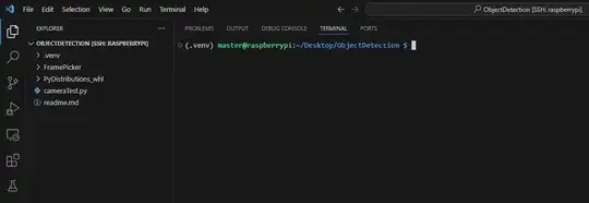

In the following screenshot, you can see my Visual Studio Code on the WinPC, where I am already connected via Remote-SSH to the RPi. What should I type to check if X11 forwarding works?
