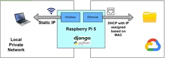

Is it possible to connect to two separate networks with a Raspberry PI 5, one using the Wifi interface where a Web application is accessible by a fixed known IP and another where the Ethernet interface gets an IP by DHCP based on its MAC address?
Yes, the two interfaces are independent of one another and would have different addresses and the full range of ports (opening a specific listen port can apply to all, some, or just one interface); the system will then route traffic to one or the other based on destination.
