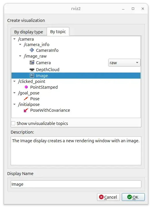

View the image in rviz
ros2 run rviz2 rviz2
Topic selection panel in rviz showing the image topic is selected
