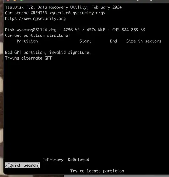

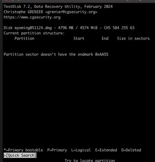

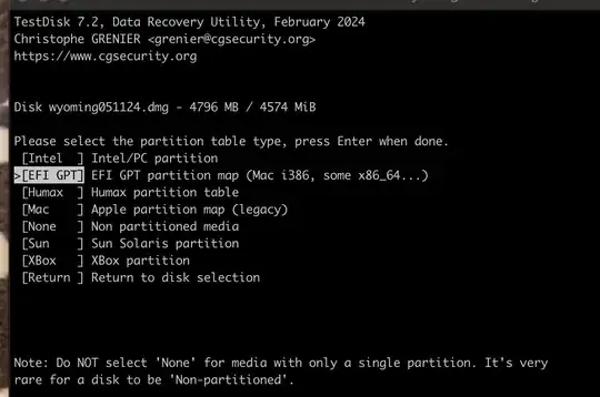

Here are the testdisk errors found:
Main Screen of TestDisk
Intel partition
GPT partition
