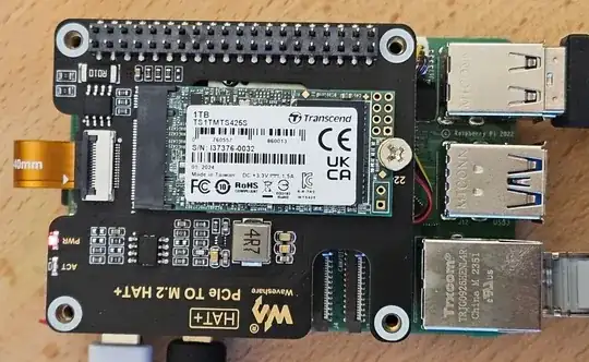

I am trying to install a PCIe HAT from Waveshare with the Transcend M.2 SSD TS1TMTS425S.
HAT and SSD

But lspci does not show the SSD:
$ sudo lspci
00:00.0 PCI bridge: Broadcom Inc. and subsidiaries Device 2712 (rev 21)
01:00.0 Ethernet controller: Device 1de4:0001
What can be wrong?

The Transcend TS1TMTS425S is a SATA SSD. The Pi does not have SATA capability, and the M.2 adapter only supports NVMe SSDs.
My best suggestion would be to use it via a SATA M.2 to USB adapter, or buy an NVMe M.2 drive.
