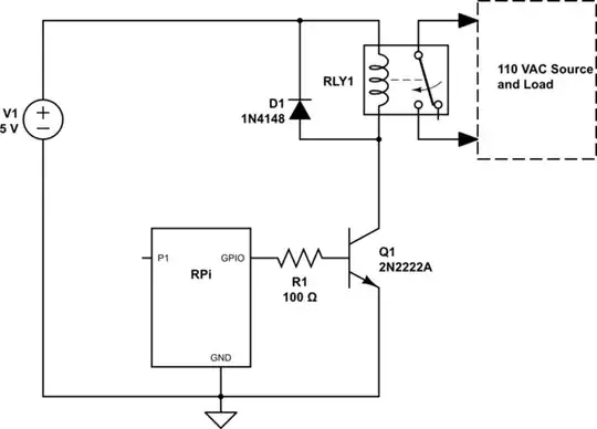

new here and to Raspberry PI. I want to use it to be able to toggle a relay, but that relay is a 5v one, and I read that the GPIO pins are only 0-3.3V. Is there a pin that can provide ground when toggled? Can any of the +5V pins be turned on/off? I'm afraid if I use the 3.3V to activate a 5V relay, it may not provide a good enough contact and cause a fire. It's switching 110V AC.
This is very true! You should not use a GPIO pin to switch a 5V device (esp a relay coil) ON & OFF.
No. The "+5V pins" you're referring to are not "GPIO pins" at all. They are simply "header pins" that are connected to the RPi's +5V bus. This +5V bus is the regulated input voltage (Vin) that comes from the USB power connector. These +5V header pins are not switched at all - they are simply provided on the header for convenience; for example, if you needed +5V to power something on a "breadboard" adjacent to your RPi.
Not much worry of fire, but you will most likely damage your RPi by connecting the 3V3 bus (aka 3.3V) to +5V. The 3V3 bus is derived from the +5V Vin used to power the RPi.
All of that said, you actually can toggle your +5V relay using a GPIO pin! Just wire it up as follows:
schematic
In this circuit, the NPN transistor (Q1) acts as a buffer to isolate the GPIO pin from the the +5V connection to the relay coil; IOW this is safe, and won't harm your GPIO/RPi. When the GPIO line is set to HIGH (3.3V), current will flow into the Base terminal of Q1, causing it to turn Q1 ON, and allowing current to flow through the relay coil - thus closing the relay contacts. The diode (D1) serves as a snubber to limit the L * di/dt voltage generated when Q1 switches OFF the current through the relay coil. Let us know if you have other questions re the schematic.

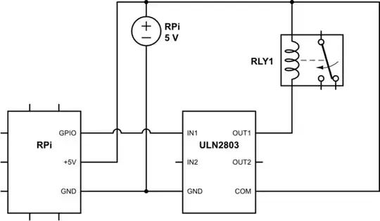

While those wirings with transistors will work, given how you ask I assume less of more universal parts might work better for you.
Look at integrated circuit ULN2803A this has all the transistors, resistors and diodes inside and works rather fool-proof in a breadboard. You could even use it for more relays or higher loads with higher voltages - so fairly universal with an RPi.
schematic
