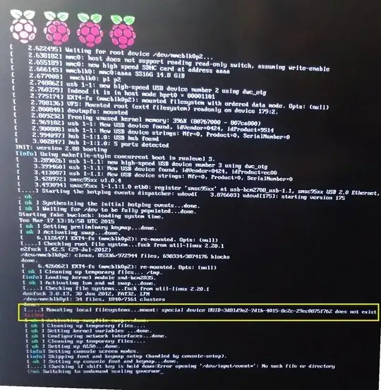

Well , true and not true In my case , RPI v2 4 core ,something has changed since v1 version as such: editing fstab in order to automount external hdd at start does not run at all , not using uuid , not using /dev/sda1
the problem is that i have to wait 30 seconds after complete boot in order to mount my external hdd drive , weird is that on USB stick , fstab runs flawlessly. So , i did a script to sleep 30 ; sudo mount -a to run things out .

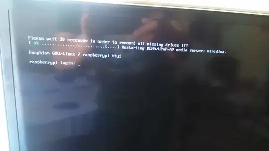

It could be something with jmicron usb adapter, without 30 sec wait it says that device is not present even though lsusb gets correct Jmicron adapter Got to dig it deep underground !!!
Here are 2 of my TV snapshots
Before
after
