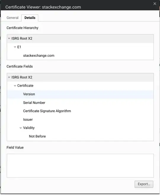

The comment:
//  CA root certificate used to sign the HTTP server's certificate (DER
//  format, char array representation).
is saying that you need to find the Root CA certificate that was used to sign the chain of certificates that signed the certificate used by the HTTPS server.
For raspberrypi.stackexchange.com, this is the certificate called "ISRG Root X2" highlighted in grey below.
This certificate needs to be in DER (binary) format. Unfortunately, Chrome doesn't have an option to export the certificate in DER format. After exporting from Chrome I had to use the following OPENssl command to convert the certificate to DER/binary:
openssl x509 -outform der -in "ISRG Root X2" -out "ISRG Root X2.der"
Then use xxd -i to convert the binary DER file to character array format and paste the character array into your header file.
xxd -i ISRG\ Root\ X2.der
