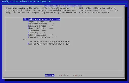

Create a directory to work in. You will probably want to keep this around, since while it will not be necessary in order to use the toolchain (which ends up somewhere else), it will save you a lot of time if you want to re-build it for whatever reason. cd into this directory and begin with ct-ng menuconfig. The interface below should appear.
crosstool-NG
This is very similar to the menuconfig interface available for configuring a linux kernel build, and like that, it also leaves behind (and initially loads, if it exists) a .config file which will be used for building the toolchain. Fortunately, there are not nearly so many options to go through here as there are with the kernel, and most of the defaults are suitable. I won't go over all of them, just those that are essential. The <Help> button in the bottom bar (navigate this with Tab) will give you information about each highlighted option.

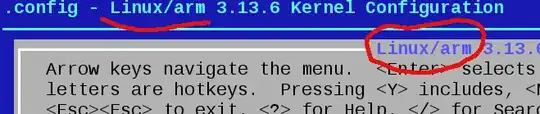

That's critical when you run make menuconfig for the kernel. Even if you are using a pre-defined .config, menuconfig will pre-process it assuming the target is your host architecture and make modifications accordingly. There is a clue about this at the top of the interface.
If that says "Linux/x86" instead, you haven't set $ARCH. Exit without saving and try again. You can do this without sourcing the make.env script by using:
make ARCH=arm menuconfig
