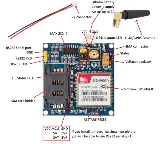

[GSM1] device = /dev/ttyAMA0 incoming = no #pin = 1111
My /boot/config.txt contains:
[GSM modem on GPIO 14/15]
enable_uart=1
dtoverlay=miniuart-bt
What is causing this? I've tried a few different wiring configurations, and I still get the same error: wiring #1
and the simpler
wiring #2
(mutatis muntandis)
