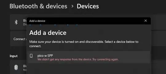

Compiling worked. Then after copying the .uf2 file to the Pico, on my laptop in the Bluetooth settings, the Pico appeared but wouldn't pair when clicked on:
pico not pairing
