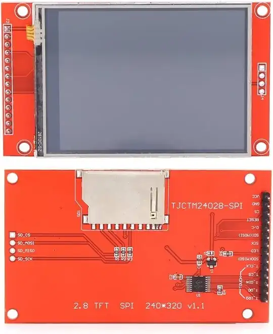

I am doing my NEA project right now and I have a problem using 2 TFT LCD. Here are more details about the LCD 2.8" LCD SPI, Driver: ili9341 with touch version 1.2, this a picture of it: enter image description here

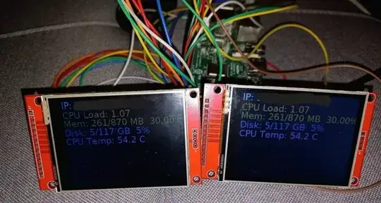

this only works with the ili9341 driver display i am not aware of how I would do it with a different driver But if you want to find out how to do it I used these websites: -enter link description here -enter link description here -enter link description here Here is a picture of it enter image description here
