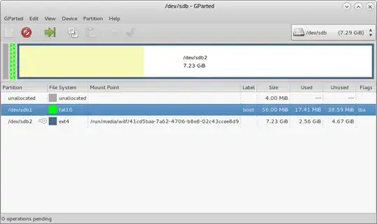

Currently, one of the best disk management utils seems to not have been mentioned - GParted:
pic of GParted
This is included in many Linux distros, and can be installed easily otherwise. For other systems, it is possible to run it off of a DVD or USB stick, so it can be used there as well. The Linux part also means it supports the SD card format if it is ext*, so it can be reformatted easily and efficiently, and less problems are likely to occur. Most disk utils, particuarly on Windows, will likely destroy any boot data on the SD card and muck it up in other ways.
Here a screenshot of GParted showing the contents of an SD card with Raspbian on:
Note: The boot partition will likely have a label or flag 'boot'
To carry out operations on a partition of an, right click on it, and select 'Unmount'. If a partition is mounted (shown by a set of keys next to the partition name), no operations can be done on it. Once it is unmounted, you can check it for errors, reformat it, rename it, delete and create a new one, etc.
Documentation on using GParted can be found here

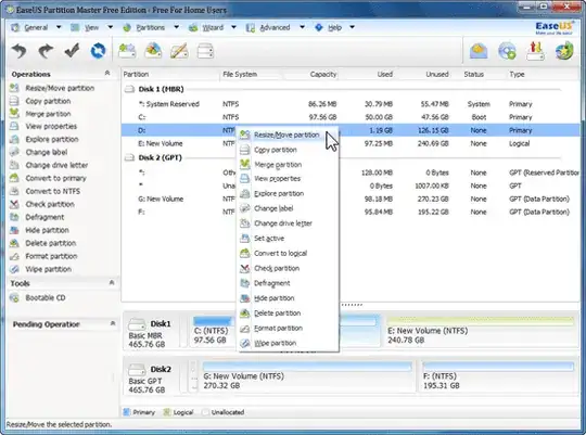

There are some specific tools for SD cards only, but I like to use EaseUS Partition Tool which is free for Windows users. It will not work on Server Editions. * Please be aware that apparently they are bundling some software. Click on advanced options to prevent this.
You should take care to select your SD card from the list of devices as this tool will list all your drives. This shows how to resize a partition.

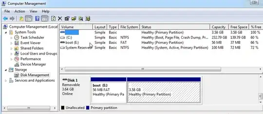

This is my 4 GB Raspbian SD card. I used Windows management tools. Yes, it shows it, but it won't let you do anything to the partitions just in case ... you delete it or Windows corrupts something (because it does not support that file system).

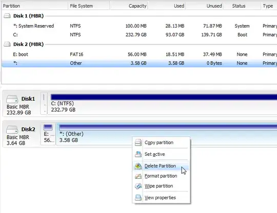

EaseUS partition master shows a much better list and understands that file systems used. Right click and delete the partitions. You can create new partitions too and apply everything and you will have the whole SD card back to use in Windows or if you want to burn another image to the card.

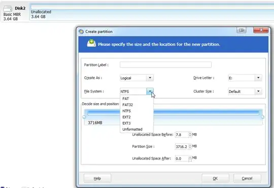

Here I have deleted the partitions. Right clicked and said "Create new partition". There is a whole list of file system types. I did not click apply, so no operation has been done yet.

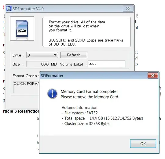

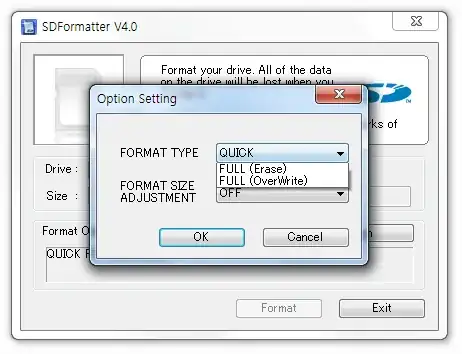

Something of note when using the official SD Formatter tool. (This really should be a comment, but apparently i can't add a screen grab to a comment.)
this tripped me up for a day or so. I ran the SD Formatter thinking it would repair my SD card. I observed that drive J: size was only 60Mb. It's a 16Gb card. I thought that (as per the format tool I've been using for the last 30 years) that it would only format the 60Mb partition.
MISTAKE. It actually repartitions the device to a single full-size partition and then formats it (in this case to its full 16Gb - see foreground window compared to background window). THIS This is the tool you need. Hands down. no questions asked!!
