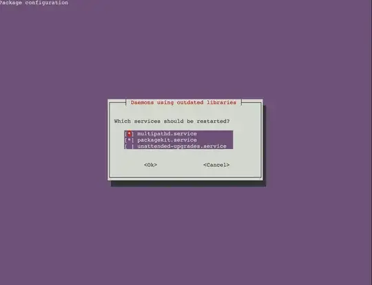

  4. If I am connected over SSH and leave the computer alone the ssh pipe will break. I can't ssh back in even after power cycling.
  5. If I keep with the computer SSH does something I have never seen before and somehow gives a full screen GUI warning me about Needsrestart.
And that's about where I'm at. A few observations I guess:
  1. If I connect the sd to my computer and try to open etc/bin/bash in a text editor it is un-intelligable. Same with zsh. Many tutorials mention I might be able to edit these files to boot into safe mode, get out diagnostic info etc.
  2. I have never before seen a full screen GUI pop up in vnc (except for like text editors and gdb). It's a purple screen with like an alert. And it will list like 2 things and say ok. I think it's something about Needsrestart or Daemons using outdated libraries. This pops up after the installation. I believe it just asks me to restart certain things.

Edit: I was able to reproduce this issue on a DigitalOcean Ubuntu server. Or at least the purple screen. It looked just like this enter image description here
