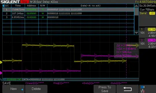

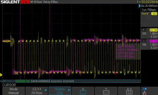

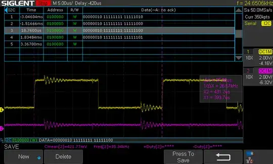

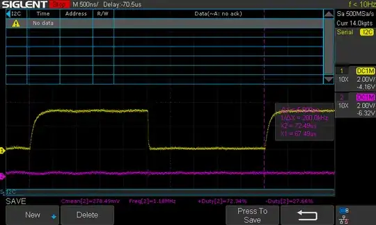

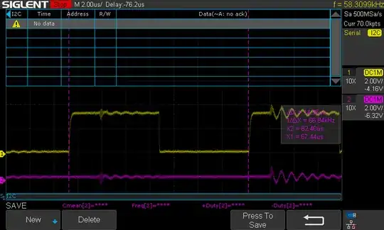

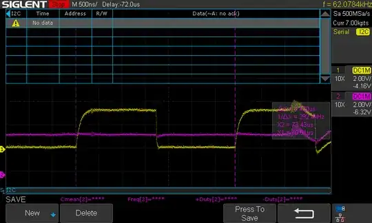

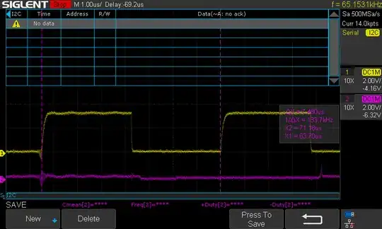

I've noticed that regardless of the speed I set it at, the actual measured clock frequency is significantly slower, roughly 33% slower. I've attached some screenshots from the oscilloscope used, and will list some of the measurements I found below:

Screenshots below are in the same order as listed above. Measurements were taken by reading the difference in time (delta x) between the two cursors shown as vertical purple dotted lines. The measured delta x and equivalent frequency is shown in the grey box on the middle right (the oscilloscope traces are there but very faint, trace period is shown top left next to the M).
10kHz 50kHz 100kHz 200kHz 300kHz 400kHz
Below is a screenshot of multiple bytes being sent at 400kHz frequency setting. The cursors measure the period of 8 bits, which roughly corresponds with 33% slower (33.56kHz * 8 = 268kHz).

Found a thread that was experiencing a similar issue, I tried the solution of changing the core frequency scaling governor to performance (as opposed to the default ondemand) using echo performance | sudo tee /sys/devices/system/cpu/cpu0/cpufreq/scaling_governor and the baud rate of the I2C line now matches the setting. So seems like the variable core frequency was causing the discrepancy here.
For anyone's interest, I personally found that the I2C speed appears to scale directly with the CPU frequency, so if the frequency is 1.5/1.5MHz, I2C will run at full speed (400kHz at 400kHz setting), whereas if the CPU frequency is 1.0/1.5Mhz, the I2C will run at 66.7% of its set speed (266.7kHz at 400kHz setting).
