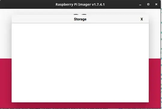

If I click "storage" while using the Raspberry Pi Imager, I only get a blank Window blank window
Selecting the OS works fine. The sd card is connected to my pc and recognized
Device         Boot  Start       End   Sectors   Size Id Type
/dev/mmcblk0p1        8192    532479    524288   256M  c W95 FAT32 (LBA)
/dev/mmcblk0p2      532480 249737215 249204736 118.8G 83 Linux
Im am using Arch Linux and install the rpi-imager from AUR. There are two packages and I tried both
aur/rpi-imager 1.7.5-1 [+72 ~2.31] [Installed: 1.7.4.1-1]
    Raspberry Pi Imaging Utility
aur/rpi-imager-bin 1.7.5-1 [+16 ~0.44]
papanito
  • 133
It seems like a recent update to the util-linux package on Arch (that includes lsblk) makes it so that some SD cards are no longer flagged as removable. This makes them not selectable from the UI.
There's already an issue created to address this case.
For now you can try to create the image via the CLI with the enable-writing-system-drives flag (which includes "non removable" devices) such as:
rpi-imager --cli --debug --enable-writing-system-drives [image file] [SD card device]
