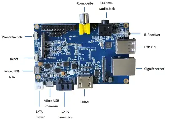

There is the Banana Pi: enter image description here
It can apparently run Debian (or Raspbian, but apparently Debian can be used), Ubuntu and 'bastardized Linux' (Android). It seems to have all/most of the features of the Raspberry Pi, with a few more:
  • Allwinner A20 ARM Cortex-A7 dual-core 1GHz GPU with Mali400MP2 GPU
  • Extensible Storage with SATA connection
  • Microphone input
  • Gigabit Ethernet
  • 1GB DDR3 DRAM
  • IR receiver, Micro USB OnTheGo connector, power switch, reset switch ...
It can apparently run off of a 5V USB supply, but might need at least 2 Amps
More info:

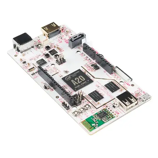

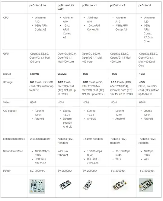

pcDuino is a great embedded device purely for the use of Linux (Or the Bastardized Version of Linux, called Android)
The biggest version with comes in at $76 at SparkFun (But other venders are available and may be cheaper) but sadly it doesn't meet the Gigabit requirement (But you can add a USB Gigabit) Otherwise it is packed with allot more features and runs Ubuntu LTS!
--Edit Nov'2015
There are newer version available now, Like PCDuino8 Uno
