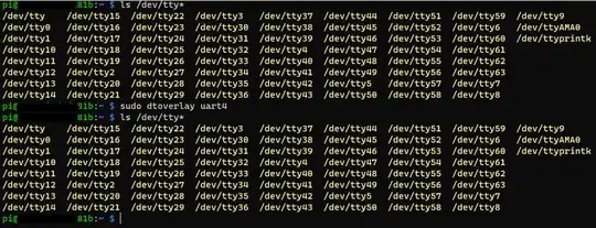

I need to be able to enable uart4 on a Pi4 using dtoverlay, without adding it to /boot/config.txt, and have /dev/ttyAMA2 available immediately. The dtoverlay part is easy, sudo dtoverlay uart4, but /dev/ttyAMA2 does not show up.
Why? Because I am setting up automated configuration of a device and while I'm writing dtoverlay=uart4 to /boot/config.txt, I need to be able to immediately access that serial port without a reboot, in order to flash firmware to a device on that port.
dtoverlay -l shows the overlay. I just don't understand how to get /dev/ttyAMA2 to show up as a device.

It is far from clear WHY you don't want to use config.txt.
You can enable a dtoverlay on the fly with the following command:-
You will need to repeat this every time you boot.
The serial port will be assigned the next available /dev/ttyAMA This will normally be /dev/ttyAMA1
See https://raspberrypi.stackexchange.com/a/107780/8697
