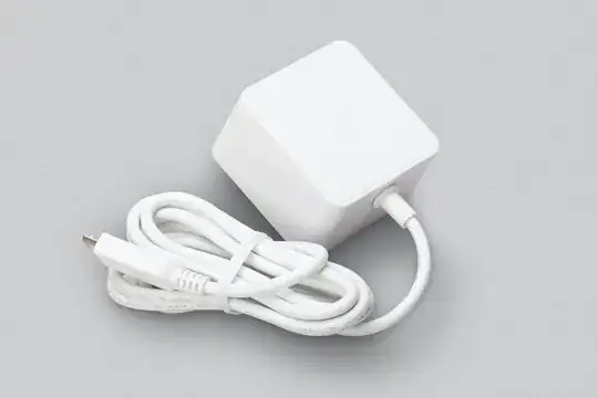

If you have an Apple (iPhone or iPad) supply they work reliably (although you still need a good cable). I have also used a Belkin 2.4A supply.
Stop wasting your time and buy an official power supply.
They are excellent and good value for money.
https://www.raspberrypi.com/products/micro-usb-power-supply/
