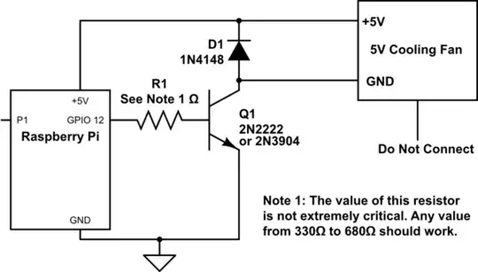

Follow the schematic below to wire your fan. Note the fan lead connected to the GPIO should be left unconnected - as per the schematic below.
schematic
To control the fan, you may use a device tree overlay which is easily configured in the folder /boot/config.txt. If you are following the schematic here, you may open the file /boot/config.txt in your text editor, and add this one line at the top of the file:
dtoverlay=gpio-fan,temp=60000,hyst=5000
Save the file, and reboot (pull the power plug & re-insert).
The fan will turn on when its temperature reaches 60 deg C, and will remain on until until the temperature falls to 55 deg C. With fan off, the temperature may rise again to 60 deg C - at which point it will turn on again, and the cycle repeats; i.e. the fan is controlled by the temperature of the CPU within a 5 deg C hysteresis loop.
