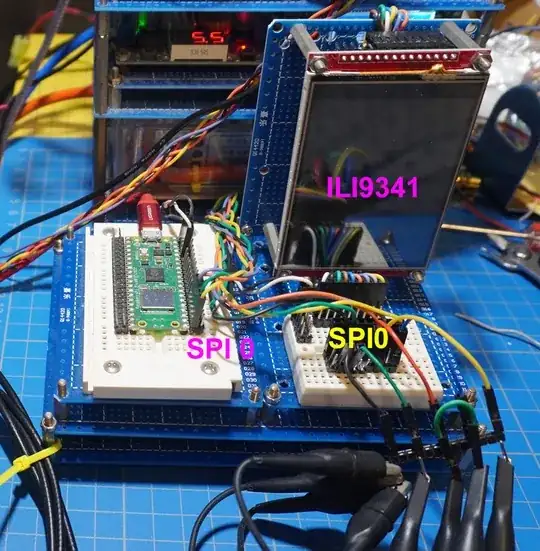

So i was in my chair and i clicked run script and when i got up i tripped and lightly hit my breadboard and then the screen (ili9341) went white. Before i hit it, it was working but not anymore. I tryed decconect the pico and put it back on then but it didn't work so i tryed re downloading (i only put it into boot mode then put the circuitpy file and didn't use the flash_nuke file) circuitpy and didn't work as well, wiring seems fine and i dont think i broke anything, i just almost touched it.
Note: Actually i fixed it. I think it was just a little connection problem. It does it often but i figured it all so it's good, thx for helping and the links in the reponse are helpfull so thx.

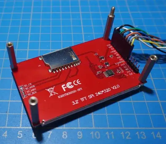

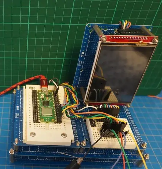

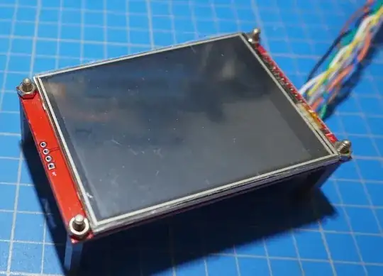

(A) How to use Rpi Pico W to repair a broken ILI9341 LCD display module? - Selecting the module for testing.
ili9341 1
ili9341 2

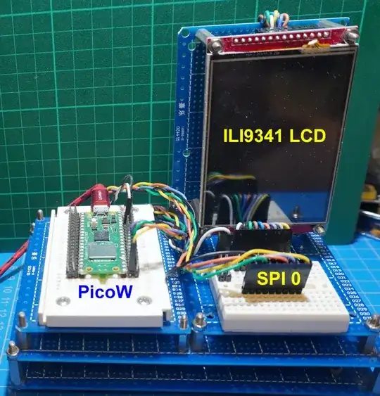

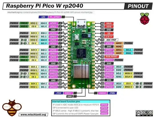

(B) Rpi Pico W SPI Wiring Notes
I am thinking of using PicoW's SPI #1 to connect to the ILI9341 LCD display module (GPIO 21~27).
SPI 1

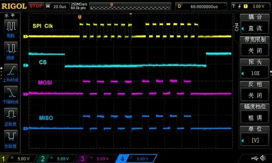

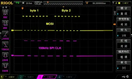

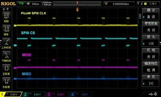

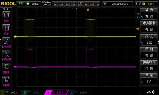

(D) PicoW SPI0 signal timing
spi 1
spi 3
spi 4
spi 5

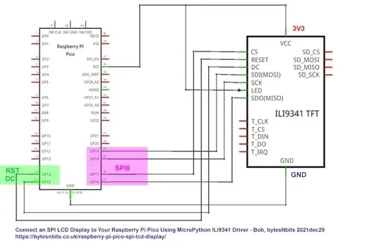

(F) PicoW ILI9341 Wiring Diagram
(a) Connect an SPI LCD Display to Your Raspberry Pi Pico Using MicroPython ILI9341 Driver - Bob, bytesNbits 2021dec29
(b) ILI9341 TFT LCD Single Chip Driver 240 RGB x 320 datasheet v1.11 - ilitek
ili9341 wiring

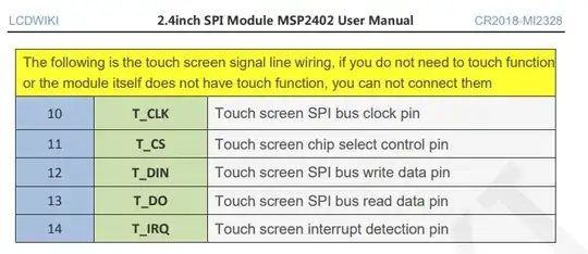

(H) ILI9341 LCD Touch Screen Setup and Troubleshooting
ouch screen signal pin wiring
(a) RPi Pico/MicroPython + ILI9341 SPI Display with Touch, using rdagger/micropython-ili9341 - HelloRpi 2021mar06
(b) ILI9341 2.4inch SPI Module ILI9341 SKU:MSP2402 - LcdWiki
(c) ILI9341 2.4inch SPI Module ILI9341 SKU:MSP2402 User Manual - LcdWiki
Touch screen signal line wiring
10  T_CLK   Touch SPI bus clock signal
11  T_CS    Touch screen chip select signal, low level enable
12  T_DIN   Touch SPI bus input
13  T_DO    Touch SPI bus output
14  T_IRQ   Touch screen interrupt signal, low level when touch is detected

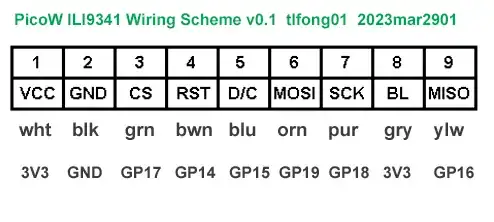

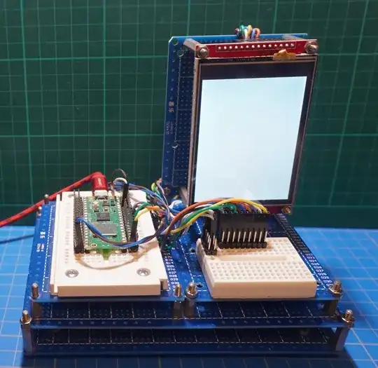

(I) So I repeated the OP's white screen
white screen 1
PicoW ILI9341 Wiring Scheme v0.1
ili9341 wiring 1

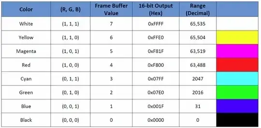

(J) ILI9341 White Screen Troubleshooting Suggestion
rgb565 colours

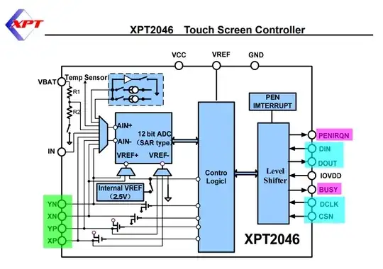

(K) XPT2046 Touch Screen Controller
xpt2046 summary
