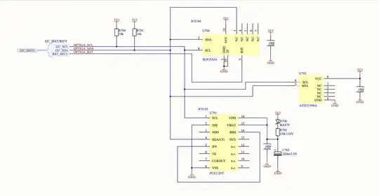

Here is the wiring of the IC for providing the RTC and an another i2c IC.

Finally I found a solution!!!!
No building custom modules is needed, only stock kernel configuration. The trick is that the I2c used bus IS NOT THE STANDARD ONE (i.e. usually with Raspberry the I2c bus is on GPIO 2 and GPIO 3, which on Kunbus are used for other pourpose). The GPIO where the RTC is attached are the GPIO 44 and GPIO 45, you could check on the provided schematic and you could even see that there are the two pull up resistors needed by the bus to properly work.
That was the difficult thing to spot, as soon as I have understood that I have decided to configure a second I2c bus and let the RTC driver use that.
