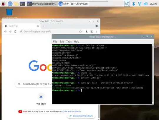

Make sure you're using Buster 32 bit. I just set up my Pi Zero W from scratch, the only thing I did was install it to the SD card, run:
sudo apt-get update
then:
sudo apt-get upgrade
and then run:
sudo apt-get install chromium-browser
In action:Chromium on Raspberry Pi W Zero
